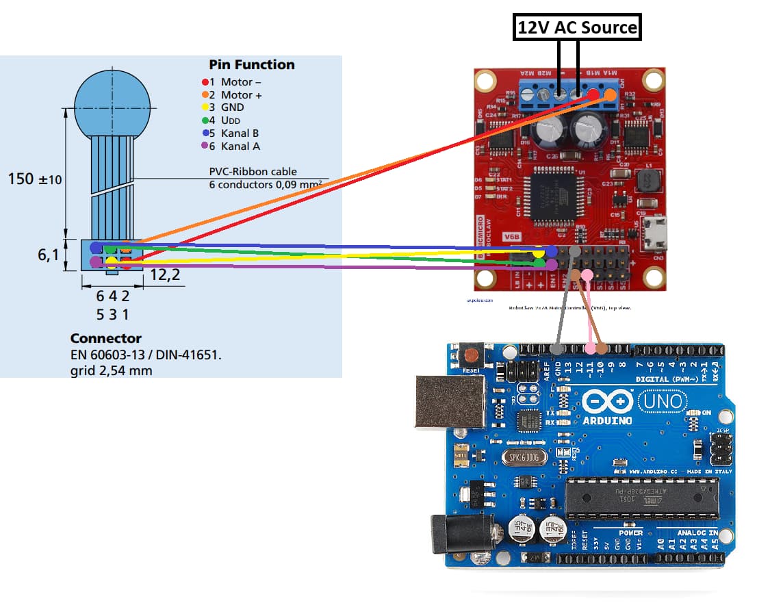

So, in the attached image are the circuit connections I did, with one motor and only one Roboclaw so far, since i’m only testing out the controls:

Could you post more information about your power supply? Is it really an AC supply as indicated in your diagram?
Also, it looks like your diagram is showing the TX and RX connections swapped. Pin 11 on the Arduino is acting as TX and should be connected to S1, and pin 10 is acting as RX and should connect to S2. I recommend making sure your physical connections are correct and checking that your RoboClaw is configured for Packet Serial mode and the same baudrate specified in the code (38400).

It’s just an 12V power supply that I connected to an outlet. But I just corrected the inverted Rx/Tx that you mentioned, and it worked!!
Thank you so much, really!!
