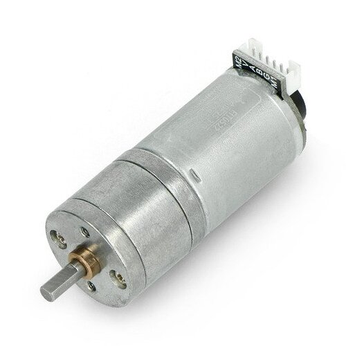

for a robotics competition I’m building a 4-wheeled robot, each wheel individually controlled by a DC motor. Currently I’m using these motors:
But I’ve only had issues with them, two of the five I bought died, suddenly they would stop moving and be really hard to turn by hand. I opened one up and couldn’t find anything weird. So I just assumed bad build quality. Now I want to buy similar form factor motors and found the 25Ds from Pololu. But even though they are way more expensive (considering they also don’t have an encoder), they seem completely identical, from torque, to speed, to looks. So what’s the difference? Or is it just a different name on the metal casing?
I’m very happy with the step down converters I bought from Pololu, but a 4x increase in price is insane just for the name.
Greetings from Germany
We haven’t specifically assessed those DF Robot gearmotors, so we cannot comment on how they might differ from ours. However, we manufacture ours ourselves, so they definitely are not identical. Please note that many things can superficially look the same but have different tolerances, materials, processes (e.g. hardening), and levels of quality control that all affect prices.

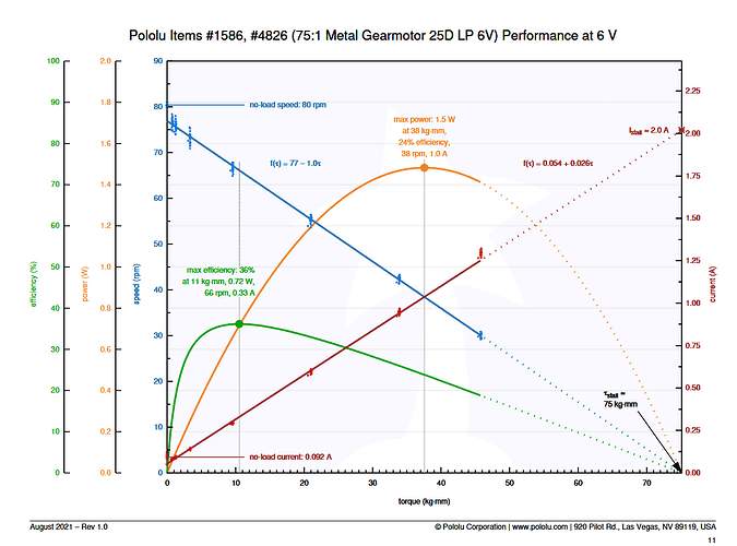

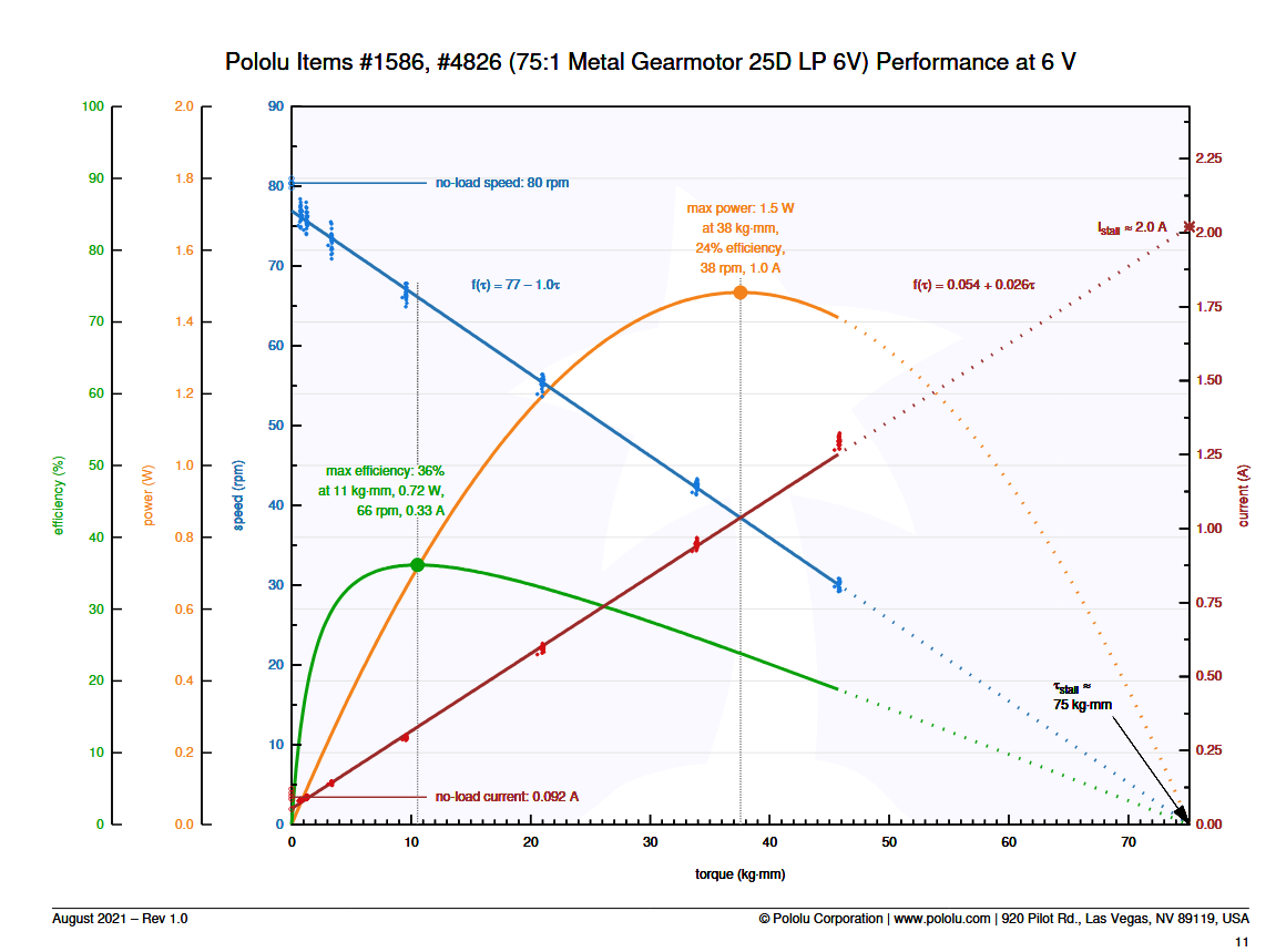

Hi, I did some research and improved my motor requirement calculations. Thank you very much for the “The Art and Science of Selecting Robot Motors” document. We don’t expect a torque greater than 0.3 kgcm, with an average continuous torque of 0.2 kgcm. According to your motor graph, this means a max current of 0.75A and an average current of 0.6A.
This seems like a safe operating torque and current. I will order 4 motors from one of your distributors and test them.
