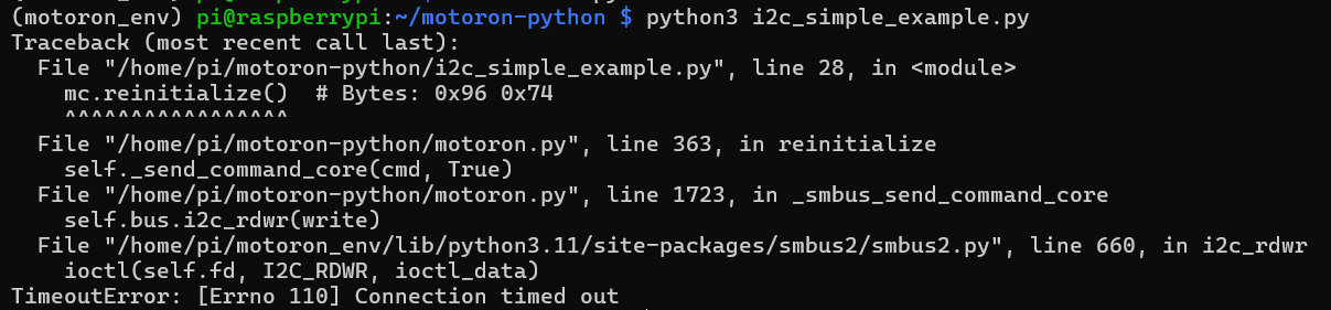

I just recieved my M2H18v18 Motor Controller and connected it to my Raspberry Pi 3, My RPi is not detecting it when I use i2cdetect -y 1, and when I try to run any of the sample project I get this error

Update: I think this thing somehow fried the i2c-1 pins on my raspberry pi. it seems to be outputting 3.7v to the SCL pin.
