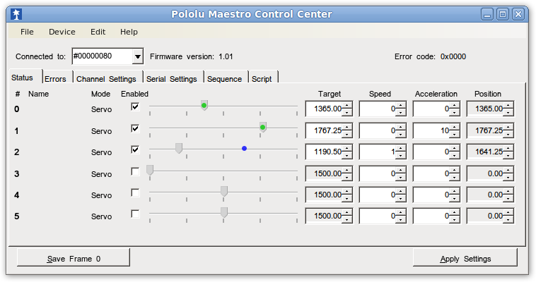

That’s cool that you were able to connect to the Maestro on your Mac! Also it’s cool that you were able to run the Linux version of the Maestro Control Center on your mac.
Which parts of the GUI are slow?
My experience when making the Maestro Control Center work in Linux was that the Linux GUI implementation differed from the official .NET Windows implementation in many little ways which caused glitches, so I’m not surprised the Linux version has glitches when you try to run it on a Mac.
A: If you want to Dual Boot, Mono GUIs work fine under Ubuntu, you can see a see a screenshot.
B: Using Mono under OS X is probably more feasible than you think; the Maestro Control Center just behaves badly on a Mac because we never tried to make it work. If MaestroExample works well on the Mac, then you’re probably ok. But your final result won’t look as good as a native Mac application.
C: Yeah, sounds tricky.
D: I personally would opt to do everything “the Mac way”. Note that you don’t have to re-write all the code in Usc.cs, UscSettings.cs, and UscProtocol.cs. Those files support ALL of the features of the Maestro, but you probably only need a small number of features to do what you want, so you can get away with writing a lot less code. To perform motion sequences on the Maestro all you need to do is find the USB device (using vendor ID 0x1FFB and product ID 0x008C), connect to it, and then initiate several Set Target control transfers (see the Usc.setTarget method, it’s not complicated). Libusb has good documentation including example code written in C and you can look at our C# code which calls libusb.
E: Controlling it from UscCmd is probably the easiest thing. You can use the “–servo” option to set the target of a servo. You should see whether there is a noticeable delay when you execute 24 of those commands in series. If there is, that’s probably because there is some overhead when starting up the Mono runtime. You could alleviate that by modifying UscCmd to have a single command-line option that sets the targets of all the servos. We don’t have any additional documentation for UscCmd, besides the source code of course. Is there anything confusing about the list of options with short descriptions?
Let us know how it works for you, and when you get it working I’m sure there are other Mac users that would appreciate having the code!
–David
