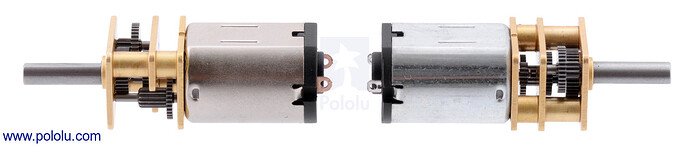

You might be able to narrow it down by looking at the motor terminals to distinguish between the HPCB versions with carbon brushes and the others with precious metal brushes:
The one on the left has carbon brushes the one on the right has precious metal brushes.
