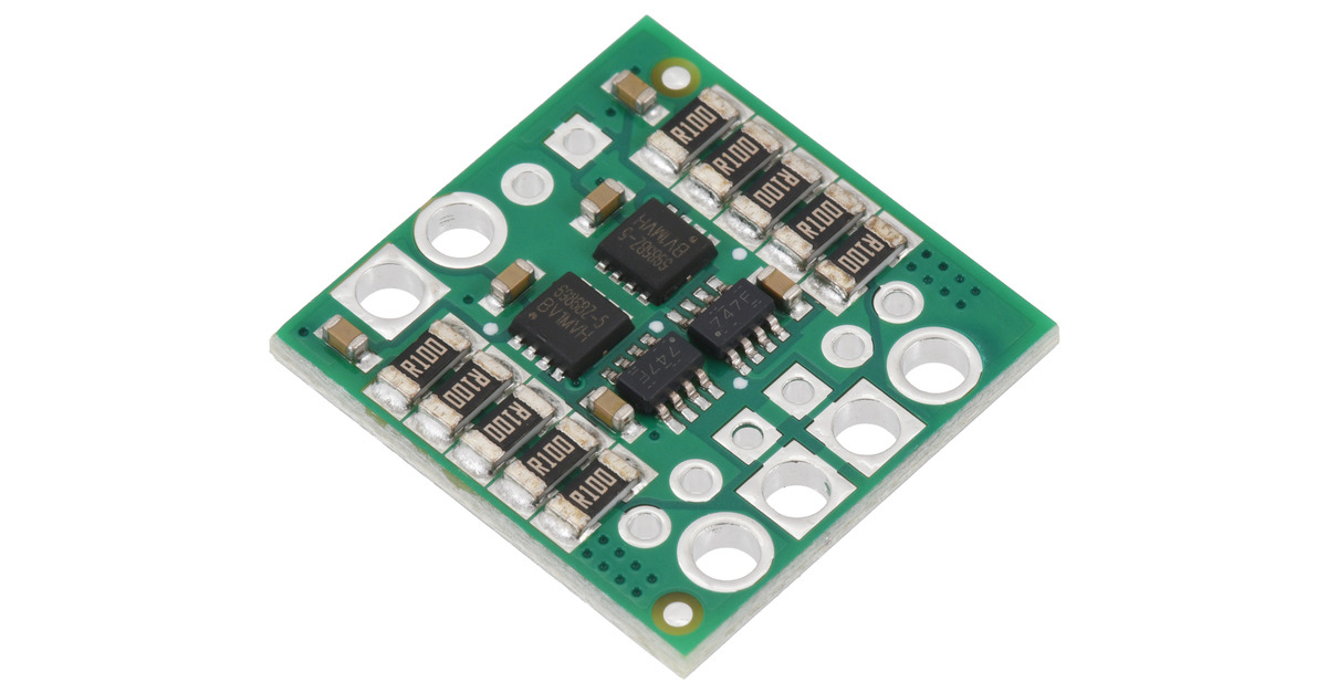

However, we just released this power ORing module:
You could use three of those on six supplies and wire the outputs directly together to get six-way power ORing.
