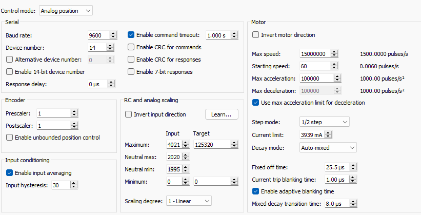

Dear Brandon
Long time ago, still the same problem… :slight_smile:
The potentiometer is set to approximately 45%: target position 0, 50% position: target position 2880.
Why does the control center scale from 0-50% to a target position of 0?
The way the scaling works on the Tic, the “Neutral” position is mapped to a target position of 0. So, if you want to only use positive target values, you can set the “Neutral min” input to 0 and the “Neutral max” input to something like 35 (if you want to keep some buffer, otherwise you could set it to 0 as well).
Alternatively, you could split the movement up so it centers on zero. For example, leave your input values as they are, but change the “Maximum” target value to 62660 and the “Minimum” target value to -62660.
