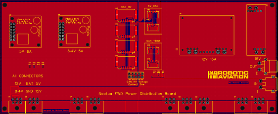

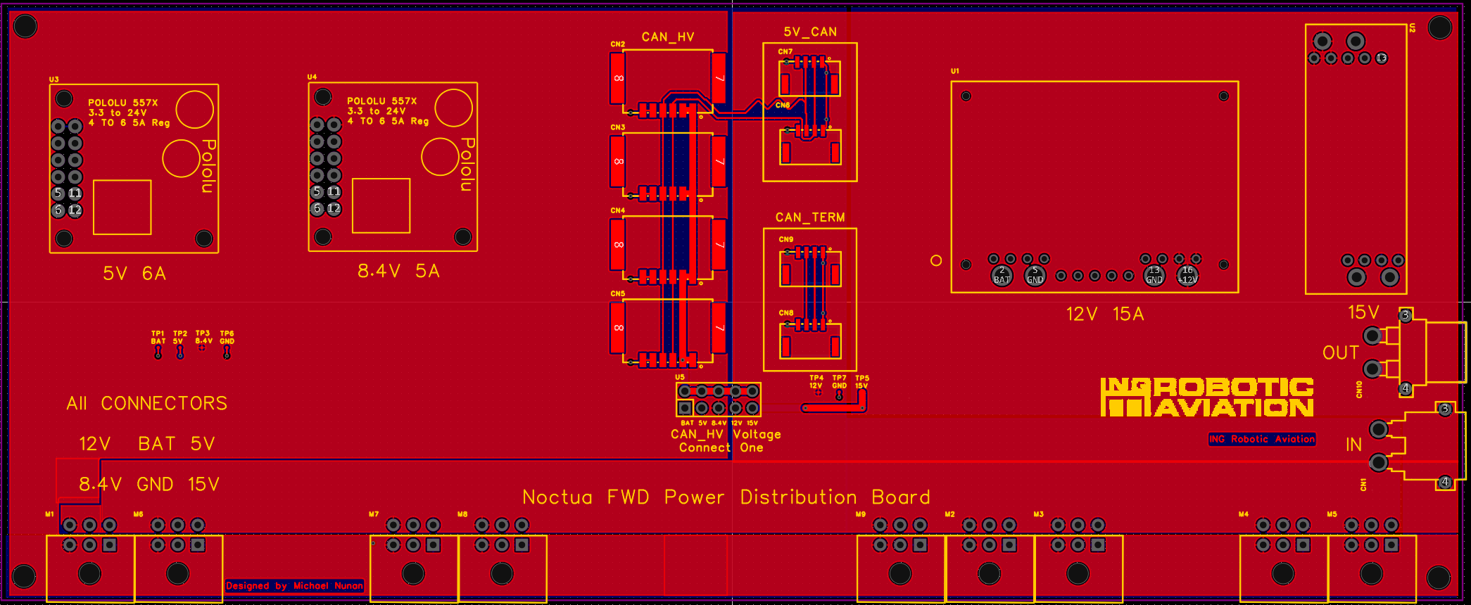

The board is mostly power distribution and is primarily copper pours.
Here is the 8.4 and 12V layer
