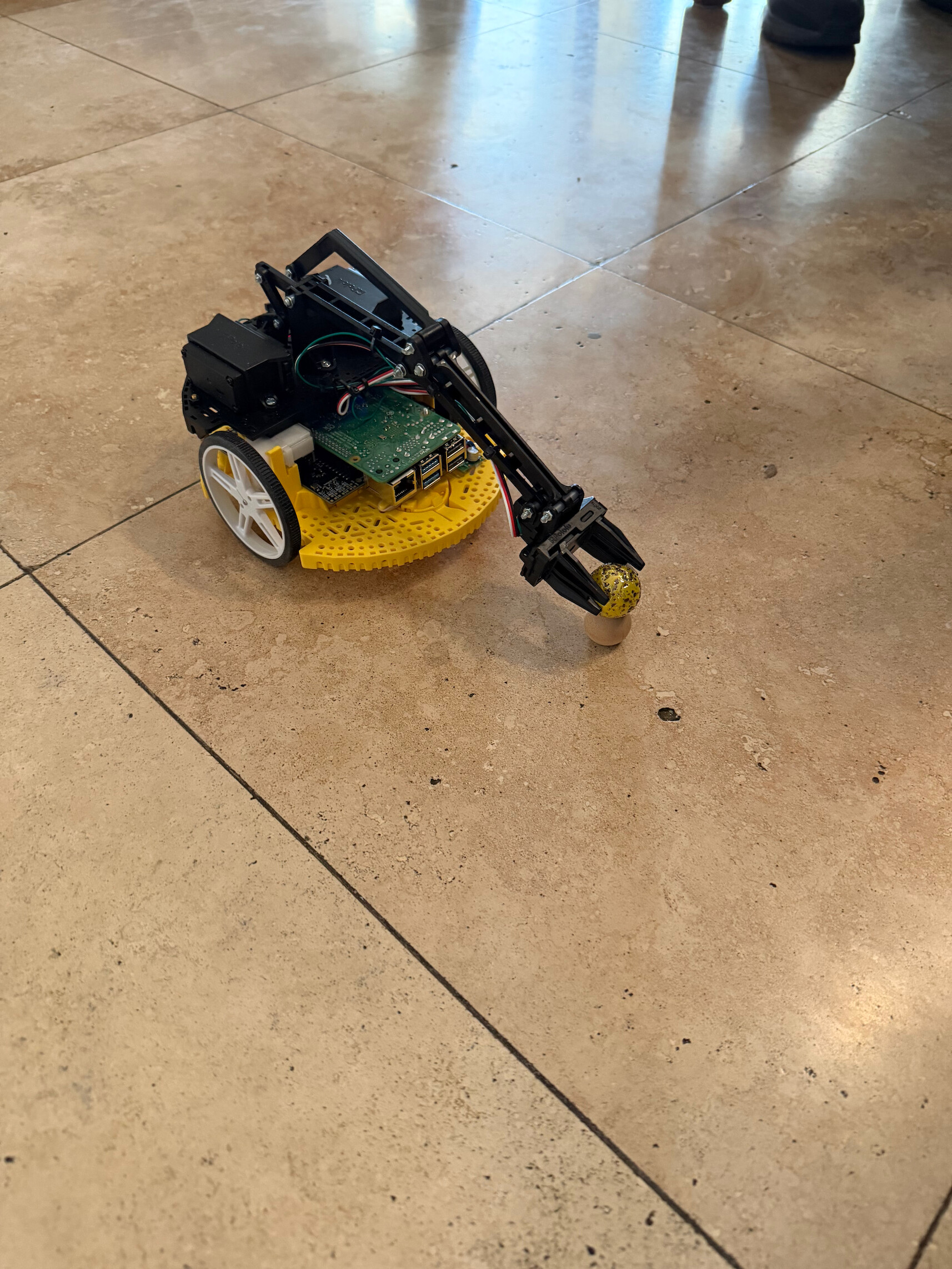

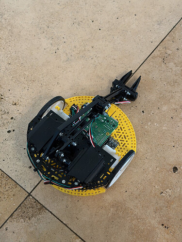

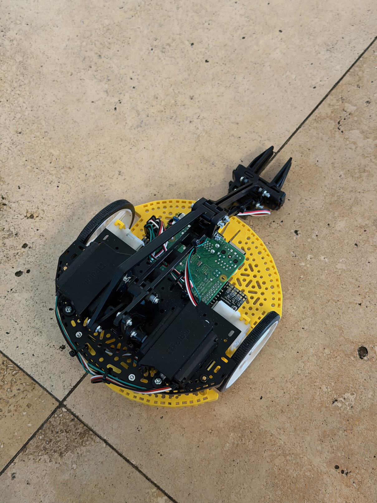

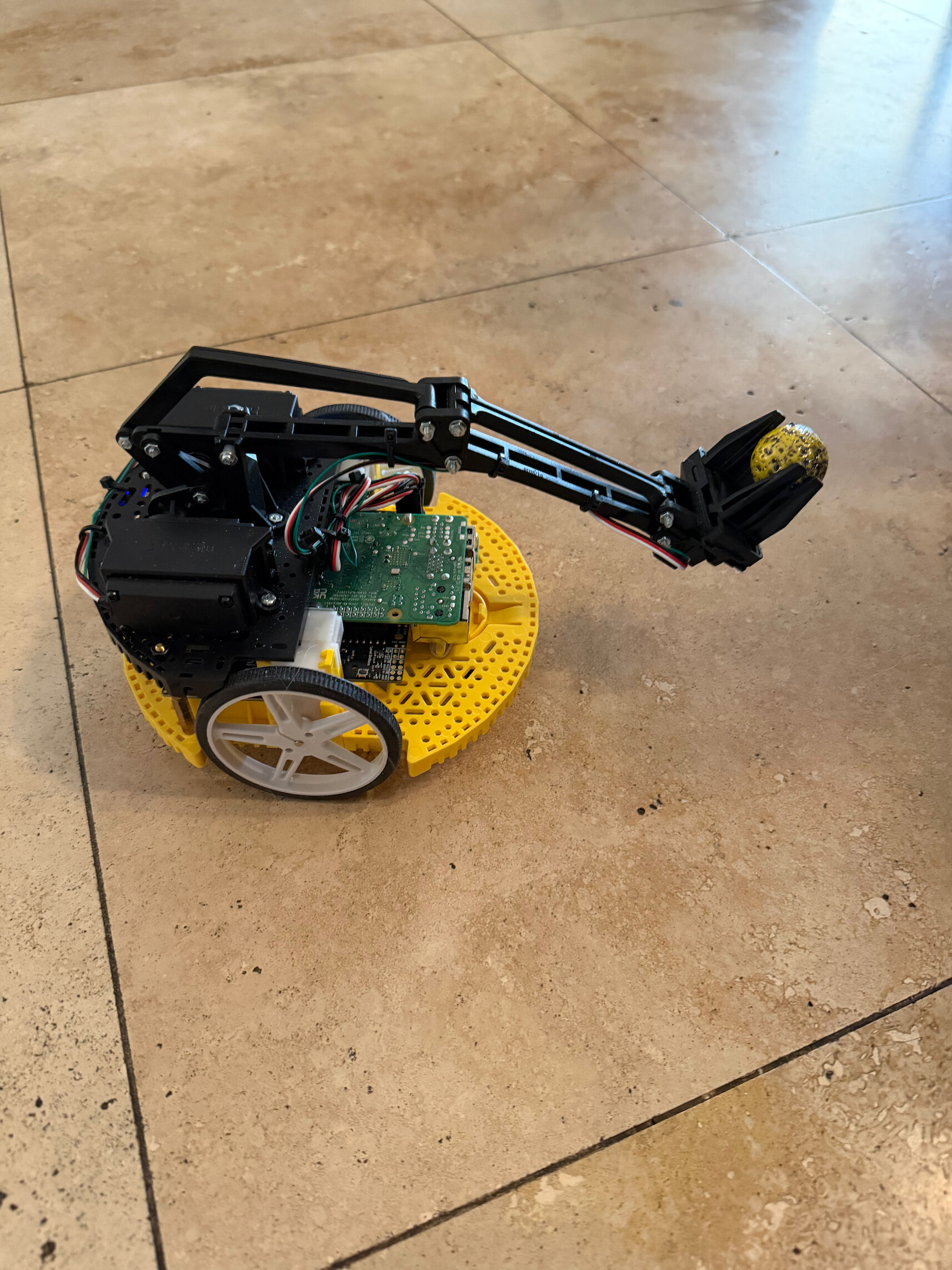

I assembled the Romi Robot Arm Kit with a Romi 32u4 board and a Raspberry Pi 4b. I used Cursor to help me build code for both the Romi and the Pi and put it in a public GitHub repository here: GitHub - jacknvegas/Romi_Project: Romi robot with arm/gripper · GitHub
The code on the Pi includes a small web page that allows you to control the robot via wifi. It gives you control of the wheels and arm so that you can pick up objects and lift them. It works pretty well, but there is still some jitter in the arm even when it is at rest. If anyone wants to take a look or try out my code, I would be happy to give you access to the repository to help me make this better.
