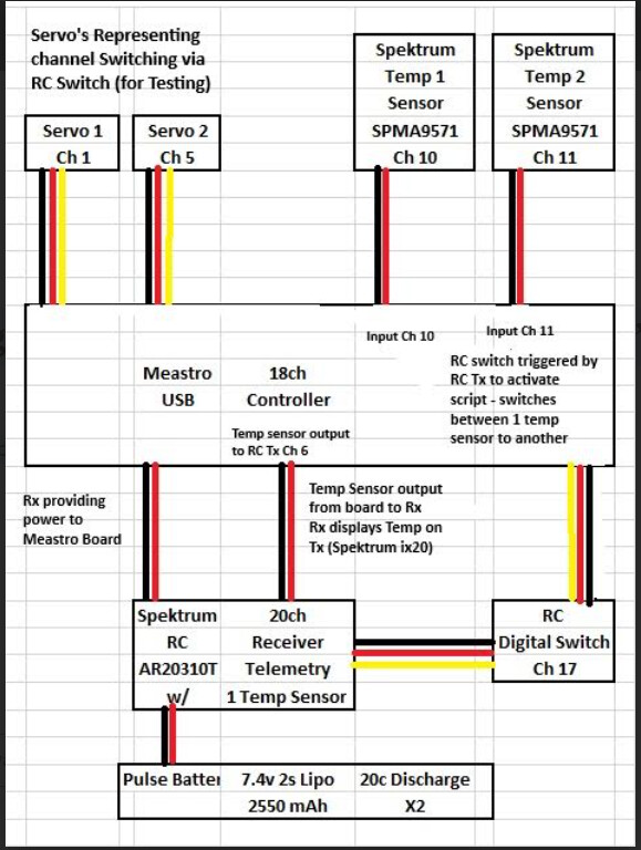

I hope this is understandable. I am working on a project with a RC inline twin cylinder gas engine. I need to read the temperature on both cylinders. The RC rx/tx (spektrum iX20) only reads one temp sensor. I was looking to put 2 temp sensors that are read separately by a switch on the Tx or a timer. Using the Maestro 18ch I have figured out how to run the switch and script it to change between the 2 channels. The last stage of testing shows that the readings from the temp sensors are showing in voltage (thermistors).
Is it possible to setup the maestro channels to input and then output voltage readings to the Rx or is this something that will require a higher controller (ex A-Star 32U4 Micro)
Settings input on 2 wires from the sensors to the Maestro Ch 0 and 5
Settings output on 2 wires from the Maestro Ch 4 to the Rx (not written is script yet)
Digital switch on Ch 17 from Rx to Maestro to switch from Ch 0 to Ch 5
Script example so far:

Rudimentary Diagram (Noob) (Ch 6 is drawn on the wrong side)
