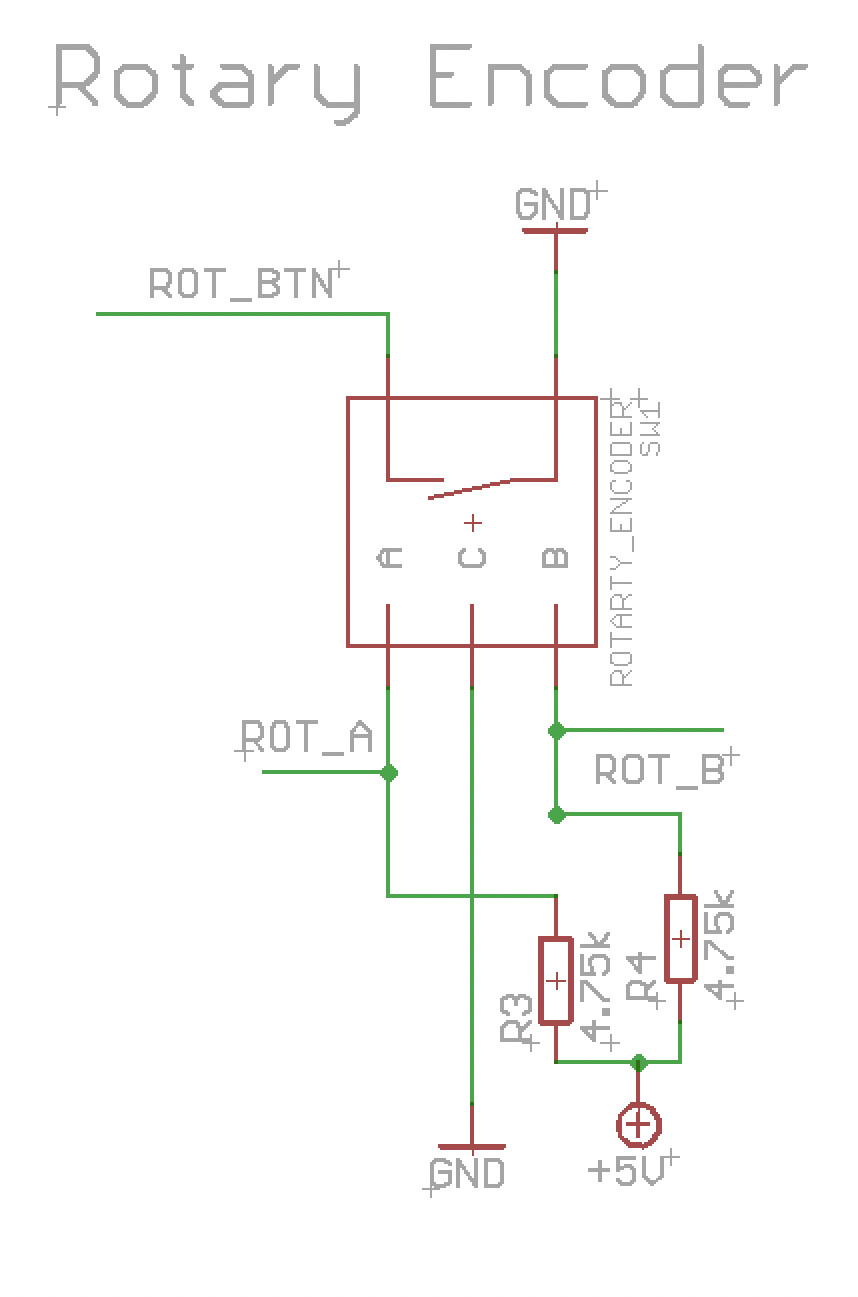

Rotary Encoder connections. I know this works with other boards on other pins, just not this one.
