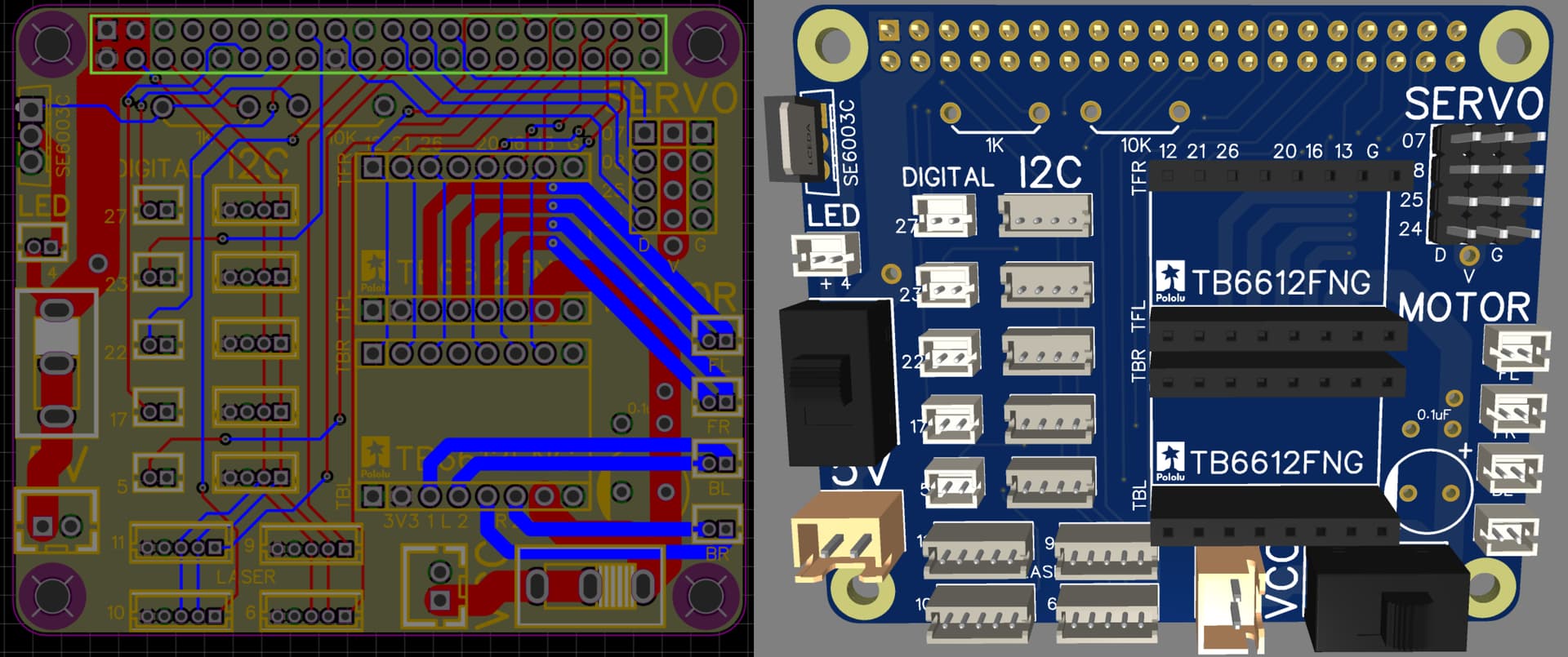

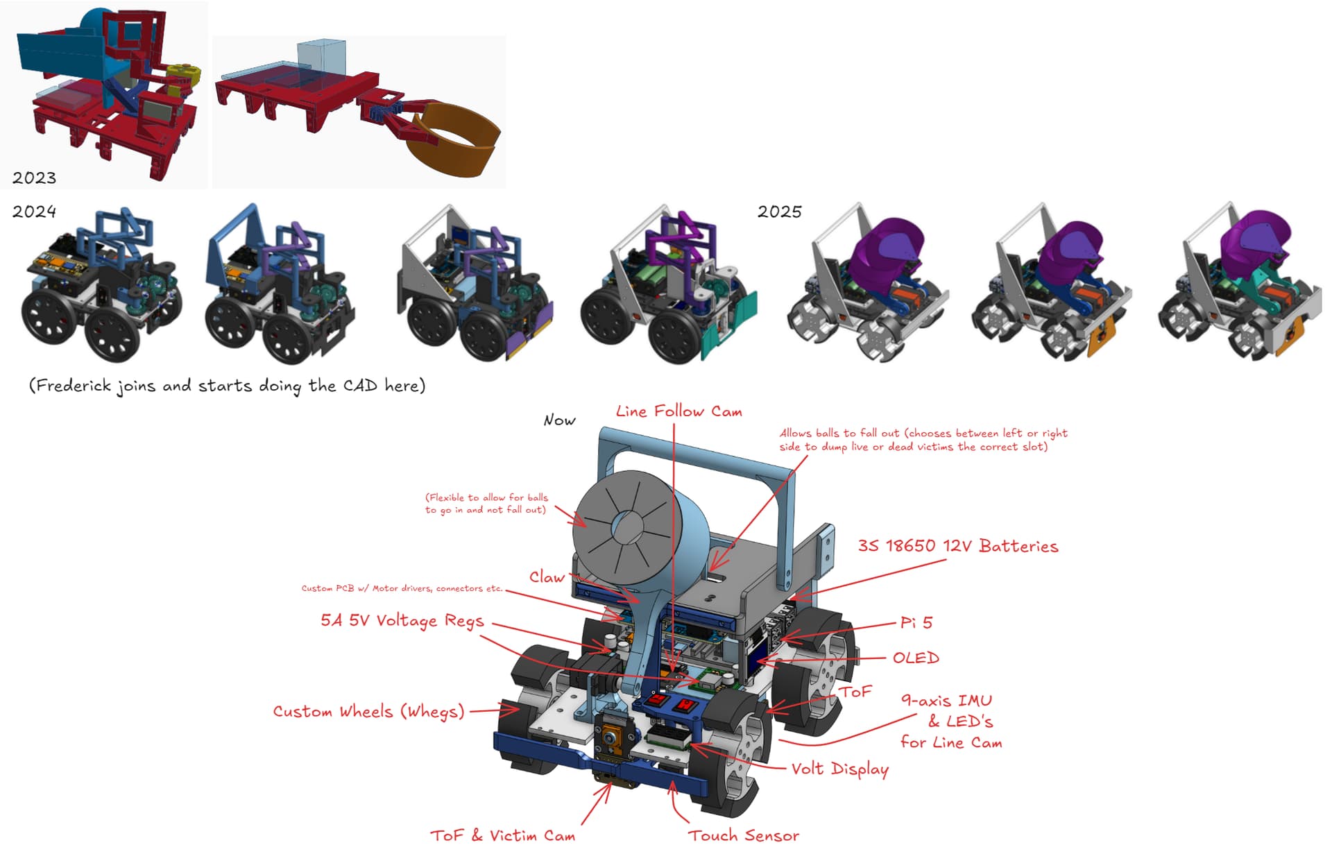

So I’ve redesigned the bot completely, and upon reflecting on this years performance I made some major hardware changes. Specifically, I replaced the drive servos with Pololu Micro Metal motors. So I also I got motor drivers that worked with the DC motors. I also got some much more reliable 5A voltage regulators from Pololu, instead of relying on Mini560’s from AliExpress. Alongside many other additions to hardware (Raspberry Pi’s newest camera with a built in AI accelerator, a bigger battery, etc.).
As of right now, I haven’t been able to 3D print the design, buy new components, and put everything together because of prelims and my family recently moving house. At this point I would really appreciate any questions, feedback, or thoughts . Me and Fred made a video explaining our 2025 bot if anyone is interested or wants a bit more clarity on what we are trying to do in this competition.
