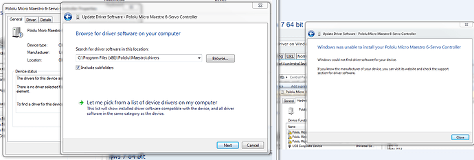

Just bought your amazing a Micro Maestro 6-Channel, but can’t install driver on Windows 7 64 bit…
Screen shot attached.

I am sorry you are having trouble with your Maestro. It should work on Windows 7 64-bit, and we have tested the Maestro on that version of Windows many times. Could you try unplugging the Maestro from USB and plugging it back in, in case that helps? If it does not, please right-click on “Pololu Micro Maestro 6-Servo Controller”, select “Update Driver Software…” and then tell windows to look for drivers in the following directory:
C:\Program Files (x86)\Maestro\drivers
Hopefully that will work. Please let me know how it goes.

I am having the same problem. Have installed/uninstalled 6 times both as explained in the user guide and per the help here using the maestro.exe.
Either way I do not get a prompt to install drivers and when trying manually I get a message that the controller could not be installed.

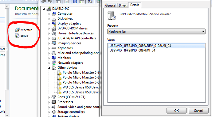

Hello. I am sorry you are having trouble with your Micro Maestro on Windows 7. To help us troubleshoot this, please double-click on “Pololu Micro Maestro 6-Servo Controller” in the Device Manager, go to the Details tab, and select “Hardware Ids”. Please post a screenshot showing those hardware IDs so we can make sure that they are correct.

Thank you for the prompt reply.
Here are the files I have tried installing(circled)…Apologies for the .exe mixup
Also the hardware id you requested.
As a side note: that info does not change regardless of software installation or lack of. Am I correct in assuming that this information is in fact the data from the controller hardware itself and nothing to do with software?
Those hardware IDs (USB\VID_1FFB&PID_009F&MI_04 and USB\VID_1FFB&PID_009F&REV_0102&MI_04) are for a custom version of the Maestro. Can you confirm that you got it as part of some other product from a different company?
